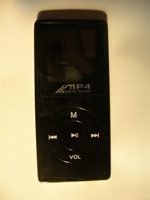

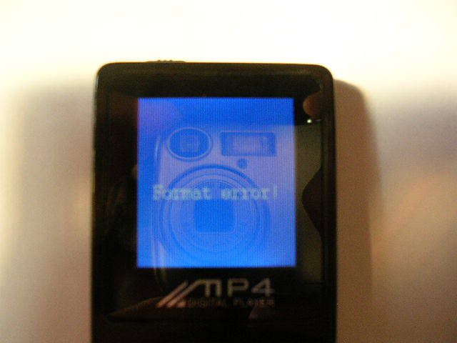

Hi I recently bought a 4GB mp4 player from ebay and at first it was working pefectly but after a few minutes of fiddling with it it stopped playing videos and gave me a "format error!" whenever I tried to play a video or image. I believe it has something to do with the a damaged firmware but I`m not sure. The videos I put in it are all amv format.
The current firmware version it has is
Device name: LISONG MP3 Player
Productor: Wilson Co. Ltd.
Version: 9.0.48
Front view of player:
Back view:
Main menu view:
The error that is troubling me
Please help!

If you bought it as a 4GB player the problem is most likely memory chip related.
At present these players only support a maximum of 2GB but some manufacturers hack the chips so that they read much larger than their true size. In some cases 4GB chips have in fact been hacked 128MB chips.
Hacked players tend to run fine for a while but as you start loading more and more files or add and remove files they start playing up, generally with file corruption, player restarts and errors.
Once you start having problems you need to format the player which will remove the hack and your players memory will then read it's true size.
They can however be difficult to format so if you have trouble try this method HERE.
Once you have got the memory reading its true size you should not have any problems.
If you want to verify your memory chips true size you will need to open the player and check the serial number of the chip against THIS list of Samsung and Hynix chips.

OMG thank you SO much!!!! I followed your guide and now its working perfect. Although I just found out I actually have a 2GB mp4 but what the hell i still got it for a bargain. Thanks again. You do good work :lol:
