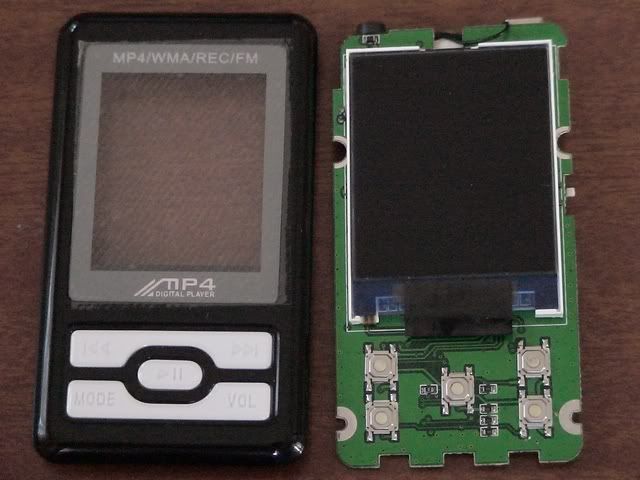

this is my mp4 player.
this is its battery
and backside of the card

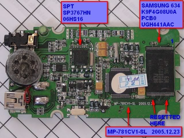

after that I resetted its pins like a snap in this site. 4 pins after 4 pins of the left, 4 pins after 4 pins of right that I snapped.
about this operation i plugged out the other usb disk.
turn off the switch of mp4 player, short circuit the pins, and then turn on the switch. only 1 time found adfu device. I am trying many times but no more adfu device found.

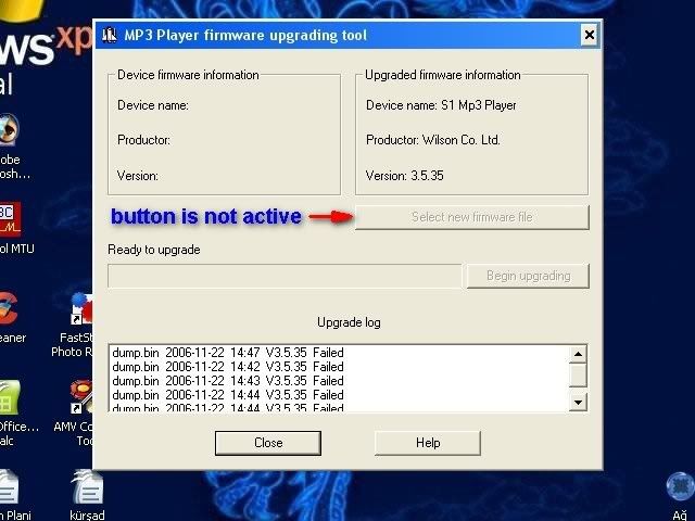

after that when plug in find usb storage disk.

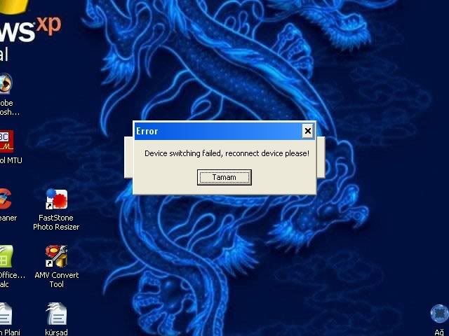

when open the "MP3 Player Upgrade Tool"; this message pops up.
And then this error.
I upgraded with my home pc.
in this pc this message pops up.
I cannot select the new firmware.
at the begining I formatted it with "MP3 Player Disk Tool"
Anyone know the answer how can I reset it and found adfu device?

chipsets properties are int the snap.

resetting successful.
1.remove the usb disk etc. (removable disks)
2.plug in the device but off position.
3.short circuit both right 4 pin and left 4 pin at the same time.
4.turn on the switch.
5.open the "MP3 Player Upgrade Tool"
6.press "select new firmware button"
7.find the original dumb.bin
8.begin upgrading.
9.pop up a new error.

when I start the "MP3 Player Upgrade Tool"
and select firmware, push the begin upgrading button.
"unknown flash error" pops up.

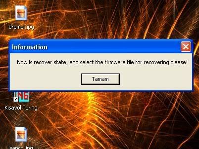

Old 3rd Dec 2006, 1:03 pm
mpxtr,
Is your player visible in Windows Explorer when you connect it?
Do you get a message saying thet the device is in recovery mode when you open the MP3 Ugrade tool?
Have a look in the MP3 Player Utilities\RDisk Update folder. If there is a folder in there named "recover" then delete it and then try uploading your dump to your player again.

i ve deleted the folder you said.
this message popped up.
and then selected a file begin upgrading. uploaded succesfully but wrong firmware again but not problem, i ve downloaded lots of firmwares. retry all of them tomarrow. now I have to sleep. it is 23:48 now.
a file created again in the same folder.
I will delete it for every once try.
thx thx thx.
