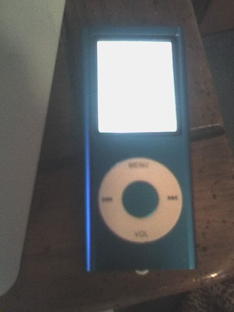

I have receieved a mp3 player from ebayer hailitele and I didn't know about hacked memory so my player was in the sand time state which sucked as ppl already know and I tried to find a better firmware which fails so to someone who has the same player from that loser could you please send firmware or if anyone knows what firmware could be used with it let me know PLEASE for more of a perference on the player.
Here is a link to the bought player: BRAND NEW (3RD GENERATION) 8GB* 1.8” TFT MP3/MP4 PLAYER.
and here is a picture of my player when i turn it on

vash8 , i'll suggest you open the player to identify the processor's serial number (eg ATJ2091, etc).
When you plug the player to your computer, does your computer still detect the player as a removable drive?

Yes it did but I uploaded a dump file now I guess it doesn't have a firmware anymore and it's back to Unknown usb so i guess I can upload another firmware but I still don't know which and this one is very hard to open and I don't want to break it but I'm sure alot of people came here from that guy he sells alot someone has to know what firmware he's using I seen some guy he has basically the same one from the same guy but he don't have his firmware either
Old 16th Jul 2007, 7:43 pm
vash8 , these players all look similar to each other in terms of appearance, casing, and firmware. But the internal firmwares are all player hardware specific.
So someone else with a similar player would likely have a different firmware as with your player. Flashing an incompatible firmware would likely kill your player and you'll need to perform a dead player recovery.
To open your player, you'll need to pry/lift up the white plastic/sticker located at the top/bottom of the player (where the on/off switch is). Hidden below it would be a screw that secures the player. Unscrewing it would allow you to either slide or lift the casing apart. Some players would need the control buttons to be depressed and rotated for the casing to be removed properly without damage.

Okay I dunno what happened but white screen is back it loads into computer and I can add files still can't see anything on the screen except white

yes i know I left good comment because I recieved it and all i had to do was drag mp3 into the folder and it was on the player so easy and sound was good so i left good comment not knowing about hack and all and it broke the same day with the sand glass I put in new firmware now I get that white screen so I don't know what to do I don't still know how to open the player without breaking it
Old 17th Jul 2007, 4:55 am
Posts: 193
Default Re: need firmware please help
You put in new firmware? That could be why you are getting a white screen. The firmware you put in was not the right one. Even though the numbers may have been the same, like 9.0.48 or 9.0.50 or 9.0.51, I found they are not all the same.
You would have to extract the firmware from the player first before you did anything with the firmware but the software to do that can only extract 9.0.43 and lower. If you extract fimware 9.0.48, 9.0.50 or 9.0.50 you won't get a full version of the firmware. When you try to put it back on the player it won't work.
You can try a different firmware from the library but your player is most likely killed.
To see if it is, if the player is turned on, turn it off. Wait for the screen to go black. Turn it back on again. Wait for 30 seconds. Your player by default starts on Music. Even though you can't see it, press the Menu button. Wait 10 seconds. You will be in the music player. Press the play/pause button. If you can hear music your player's screen may be recoverable using the dead player recovery guide. If you can't, you player is not recoverable. Updating or putting on a new firmware has killed it.
You may be able to transfer files to the file. I found that out a few times. I was able to get files onto the player but I couldn't play them.
But if you can hear music and use the dead player recovery guide, instead of using firmware 9.0.48 from the library, try using 3.5.35 or 3.5.37
I have used both successfully to recover 2 players that orginally used 9.0.51 and 9.0.50 - It could have just been the model of player I was using but I'm not sure why it worked. It worked for me. I tried it on a 3rd player and it did not work that time.
It can be a hit and miss and there are no guarantee's that you can get it working. But you can always try if you want to.

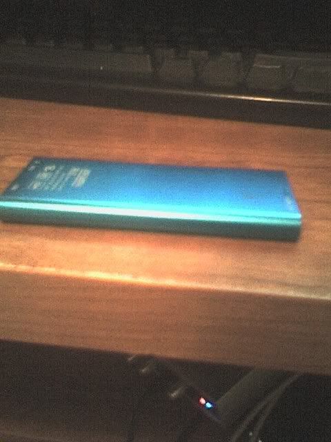

I removed screws from bottom but it still noting coming out pictures of the player having trouble getting it out what else could I do no screws are left
