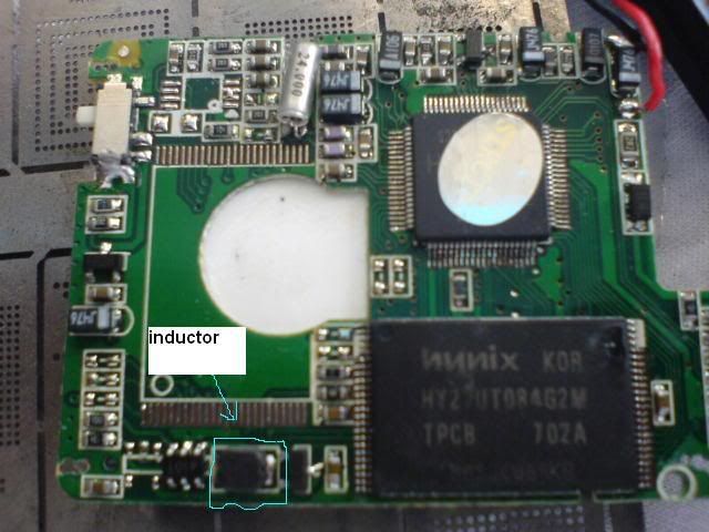

hi there,
i need firmware for my dead mp4 player,,it has amv player and a game called "russian block" and e-book,
here are the specs
Board:MP-693C-SL v1.3 2005-12.14
Processor:ATJ2085W
Memory:Hynix KOR HY27UG2M
please help me in finding my firmware.

nkakuha kc aq s s1mp3.org ng firmware,tpos ang working board kprehas nung skn knuha q pro pg nsa mp3 update tool na q,pg pindot q ng recover firmware my error,Read or write device information failed! Please exit the program and check if device is connecting! tpos mnsan "Flash is no responding" or "unknown flash error"
anu bng dpt qng gwin?
mdmi n dn aqng ntry n version ng mp3 utilities,

boss check m ung inductor malapit sa flash ic!bka open cya at pag ganun p rin reheat po ung flash ic!

pare bka pwd i2ro m nmn skn kng anu un inductor? ska qng panu ireheat ing ic?

gamit k ng hot air para mareheat mo ung ic!

boss gamit k ng tester tpos test ko kung good or bad!
mahirap kc kung wala kng gamit sa pag repair ng mp4! kung my malapit sau ng cellphone shop dun pa hot air mo nlng s knila....

anung part ung ggmitan q ng tester?

CHECK mo boss ung inductor using your multi tester!
