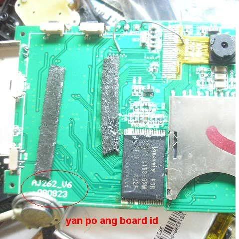

tell me the board id (look at the picture)
and i will help you find the right firmware

Default Re: Dead PMP Sunplus Recover Guide (UPDATE)
too late. i already exchanged it for a new one, which cant play GB/GBC.
