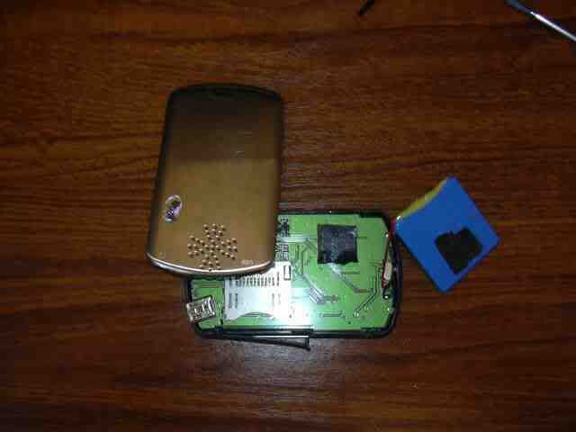

btw here is how the battery connects on my player:-

Thanx for the help,i got the battery conected to the right points,although the player still dont go on..I'm gonna use a tester tomorow to go over the whole board.My problem is now ive tried the steps u said but windows cant read the drive. it picks up the device as a rockchip usb mp3 when i plug it in the way u mentioned,although it dont want to read or write any info to or from the player? Do u perhaps know if there is any way to do a hard reset on the board becaus eits almost like the chip got blocked in a way when i updated it with the wrong firmware or in a wrong manner. Also even though windows picks up the rockchip usb mp3 when i go into consumer update application and give comand to update firmware it says it cant find any rockchip device.
Also my player looks different to ur picture,also chrome but card slot at botom,my battery is bit larger in length and theres a speaker at the back.Thanx for ur help if u have any more info id realy appreciate it,i already bought another player but this 1 seems to bug me coz i know it was fine untill i tried updating it so i wanna see if i can get it to work again.
