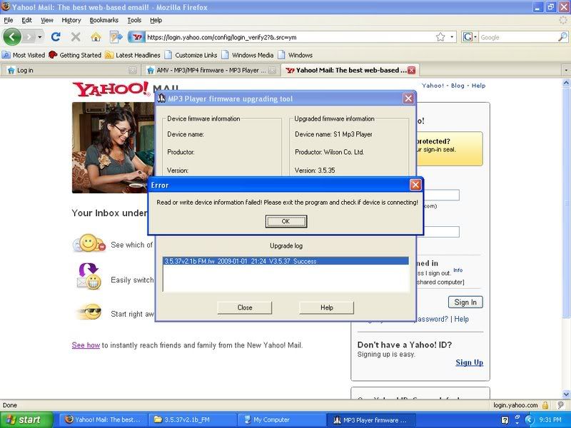

I was using another version of MP3 Utility. Now I have the one I started of with. But there is one big problem
It pops up a window that says
"NOW IN RECOVER STATE, PLEASE SELECT THE FIRMWIRE FILE TO UPDATE"
I have done the following but this is what I get.
I have tried to update the Firmware but I get this
[img]Click the image to open in full size.[/img]
As you can see the download status bar gets stuck and I have to disconnect the device because nothing happens.
I still can't see my mp3 drive under my computer, but because I found the write Mp3 Utility Version at least the firmware , I think we're getting closer.
What should I do?
Old 2nd Jan 2009, 5:25 pm
Default Re: Player Frozen. Need to Update
Wrong firmware version. Your player should be using version 9.x, not 3.5.35.

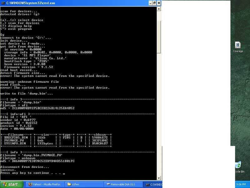

I think I'm missing files, check this out
What's the deal with the dump file, why is one generated when I run S1Wfx?
Old 7th Jan 2009, 9:30 pm
Firmware is separate from U disk.
s1fwx cannot extract version 9.x firmware.
