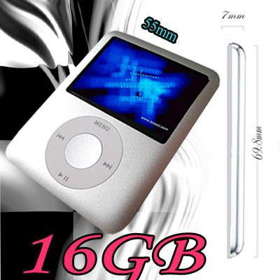

Default fake ebay 16gb actually 2GB AK2025 9800gba 08b need firmware!
Here are the specs after opening it and looking through the firmware in the settings menu
ANYONE else have one of these? (Just got it few weeks ago)
No matter what I put on it it just says
Empty disk!
I got my money back and did not have to return it!
Note nothing seems to play on it!. I would like to wipe it load it fresh with proper firmware or do something. I bought it from a ebay name Click the image to open in full size.kikikimarket advertized as a 16GB 3RD 1.8LCD MP3 MP4 Media Player 16GO FM Video SIL
(STICKER UNDER THE BATTERY)
A-N03670297AA0903480
(on the PCB )
BKEESTAR
bks2025056 mv3
080826
(this is whats on the memory chip)
samsung 921
k9gag08u0m
pcb0
FBK718XX
(here is the newer chip everyones talking about)
AK2025
9800gba 08b
(not sure what this is but here is what is on it!)
COMLENT
CL5767
X786
1909
(in the settings here is what it says)
Firmware version
MP# PLAYER
XTD_2025
2009-01-15
9.5.54
2008-09-05
It has just a headphone jack and a switch with the usb (small) on the bottom . the back has one tinny longish screw and two inside.
more from the ebay
Description
Features
16GB Flash Chip
1.8" TFT True Color LCD
Color : Silver
Bit Rate 32 to 320 kbps
Signal/Noise Ratio > 90dB
Channel separation > 40dB
Support multiple music formats: MP3.MP4.WMA.WMV,ASF WAV DMA
Song titel and lyric simultaneously displayed
Built in rechargeable lithium battery
Digital record
Picture browser
Built-in game
Use as USB flash drive
E-book function, Support txt file
Screen automatic turn-off function saves energy
Built-in FM Radio (Tuner 87MHz - 108MHz) with channel storage function
Lauguage Support:French Greman Italian Duch Spanish Portuguese Japanese Korean etc
Connectivity High Speed USB 2.0
Operating System:Windows 98/me/2000/xp/osClick the image to open in full size.
if these disappear I have a backup)
