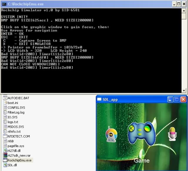

Guys, here is a first version of the simulator.
RockSimulator.zip
There is a readme.txt file
Note that I use VC++ 2008, but it will also work with 2006.
Rockchip Powah !

Wow! I'll try it out. (just need to download vc++ 2008 express first).
update: built rk27dll.dll size 1,305,600 bytes
now for the simulator...
  #269 (permalink)
Old 16th Sep 2009, 11:47 am
Built the simulator, it started to bootup, but it appears to lockup.
Update:- it's ok now. just copied RockchipEmu.exe,SDL.dll and rk27dll.dll to root of C:\ drive
This is awesome it even tests the battery charging icons. :shock:

Wow! it even plays the games from the game menu. thank you so much sid6581 for creating this for us.
btw found I have to restart my pc if I want to start the simulator again, probably just my PC lacking memory resources
