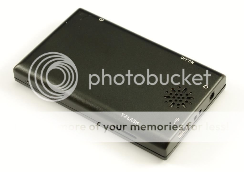

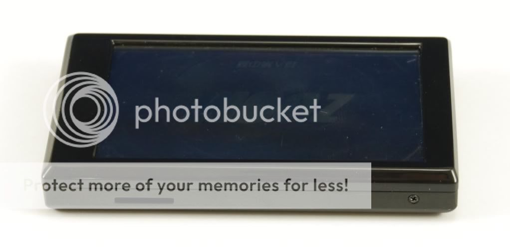

Hi, I'm a MPx noob. I hate being a noob at anything, but seeing as I just recently got in to this whole chinese mpx deal...I know nothing and research is confusing.
I picked up a Rockchip 2706 based player after the theft of my ipod becuase the price was right and it looked cool. The instructions only identify it as an RM3000.
The manual did state the firmware was upgradable with the RM970 firmware from Ramos....but those units don't have touchscreens and this one does.
It's an 8gig (non-hacked) player and I love what I've got....but the translation is horrible and I'd like to basically just see if there was some firmware upgrade for it...although from what I see on the forums is these unbranded players can't be upgraded.
I picked this thing off eBay for $70 with shipping, which is why I bought it. Here's some pictures i pulled off the auction site. I've not taken any internals as I'm not taking the thing apart..i'd never get it back together.
