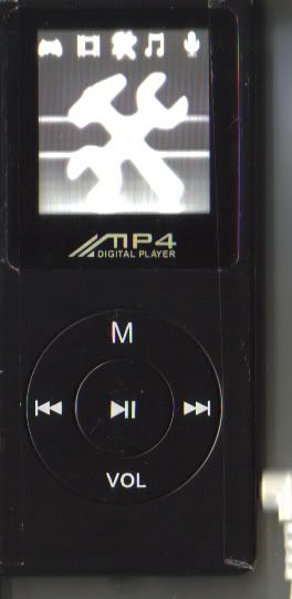

Ok, so I've extracted my own firmware and made an extra copy. I then edited the firmware with a static start menu which didn't look really good when it was on the player. I decided to look for a pre-made mod and from all on the forums, I liked Tadad's theme most: http://www.mympxplayer.org/dload.php...eec04f7b77fd87
However, the file does not have any extension and cannot be opened by the editor 2.0. Does anybody have the bmp for it in 24bit? I've read the comments and several other people have had the same problem with no solution. Tadad hasn't been active apparently for about a year =\

And I realised the player cuts in image into 4, with 3 needed images. 1 At the top, 1 in the middle and 2 on the sides (same side bar). Is there anyway to change this?
http://rapidshare.com/files/161137594/dump.bin.html
Btw the images don't line up evenly to top and bottom, as in there's a black space between the top and image image, as well as the middle image being slightly higher than the 2 side bars, which i presume is the same one!
Another thing... Mine aren't ordered the same... this is so confusing =\ Just spent 4 hours sorting this out... Lol I should be doing homework.
Being the impatient one I am :lol: I decided to go a different route, create my own theme! Oh wow it's 1am already, I 'think' I've learnt how to mod, at least the basics. Well any suggestions will be grateful, I hope to finish all the menu in a similar style and create my own end/start menus (imageshack effects + split frames works?) Umm by then, I hope somebody can help me with the vista theme for the menus and music, etc.
Yup I know its not centred, but I'll try my best to fix this up tomorrow... Any easier way for 100% precision?
