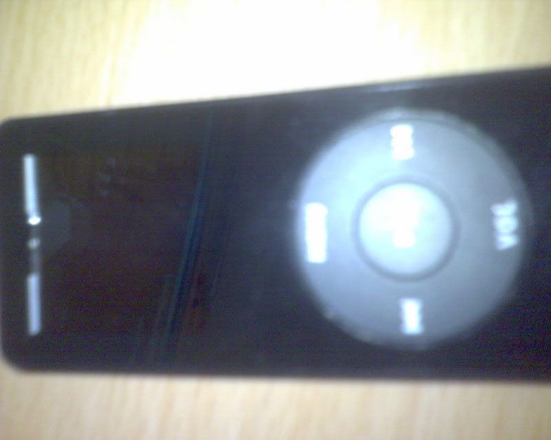

well i bought an mp4
but none of my headphones seem to fit it all the ones i have seem to be the regular size ones while this 1 seems to be smaller so i'm wondering if there are actually headphones for this
also i'm trying to put a movie onto it i converted it to a AMV but some of the picture was cut off what can i do to get full screen?

You probably have a player with a 2.5 mm headphone jack, common with these players. You can buy an 3.5 to 2.5 adapter on eBay or check a local audio store, they probably have them too.
There are some headphones on eBay with the 2.5 mm native adapter, but I haven't used them so I can't vouch for their performance.

What size is the screen? 1.5 inch screen picture setting should be 128x128. 1.8 inch screen setting should be 160x120 or 176x144 I forgot which one.
Also, I saw where you mentioned it is 8gb. There is a definite possibility that your player is hacked. You need to format using the MP3 Format tool and check out the thread How to Remove a Memory Hack. The memory hack tricks the computer into seeing fake memory and when you load it, it will write ghost files to the Chipod making it look like it is putting your movies on. Then when you try to play movies on it, you will get format errors.
If your player is hacked, contact the seller immediately and if you paid thru Paypal, open a dispute against the seller.

aww that sucks i bought one for 35 quid thinking it was 8 gig woo did the whole reformat thing its only 1gb
